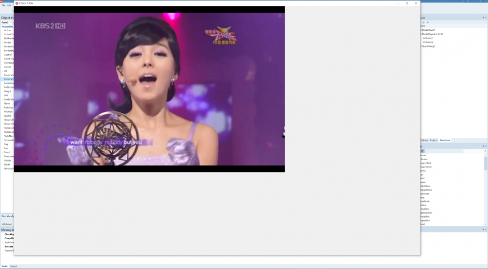

My program need to play videos with full screen and run under 4k monitor (Windows 10 64bit, Firemonkey framework).
I found a post which fixing the TMediaPlayer scaling problem by @ Brovin yaroslav  and @ cezif :
It works very fine under 1080p monitor (1920x1080).
But when I run my program under 4k monitor(3840x2160), the video can't been stretched with correct display.
Can any guys can help me to fix this problem? Thanks a lot.

Finally solved. Although it is not perfect, but it can satisfy my use. Share to everyone:
(Base on @ Brovin yaroslav  and @ cezif  's post, Thanks!)
