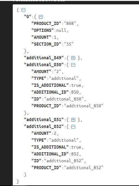

Сейчас с ходу что он не распарсил не прилетело, но вот распарсил криво:
{"0":{"PRODUCT_ID":"808","OPTIONS":null,"AMOUNT":1,"SECTION_ID":"35"},"additional_849":{"AMOUNT":3,"TYPE":"additional","IS_ADDITIONAL":true,"ADDITIONAL_ID":849,"ID":"additional_849","PRODUCT_ID":"additional_849"},"additional_850":{"AMOUNT":"2","TYPE":"additional","IS_ADDITIONAL":true,"ADDITIONAL_ID":850,"ID":"additional_850","PRODUCT_ID":"additional_850"},"additional_851":{"AMOUNT":2,"TYPE":"additional","IS_ADDITIONAL":true,"ADDITIONAL_ID":851,"ID":"additional_851","PRODUCT_ID":"additional_851"},"additional_852":{"AMOUNT":2,"TYPE":"additional","IS_ADDITIONAL":true,"ADDITIONAL_ID":852,"ID":"additional_852","PRODUCT_ID":"additional_852"}}

Брр. Почему не массив? Это массив элементов "0", "additional_849", "additional_851" и так далее. Они все находятся на одном уровне ведь. И выше них уровня нет.
Изначально была такая структура:
a:5:{i:0;a:4:{s:10:"PRODUCT_ID";s:3:"808";s:7:"OPTIONS";N;s:6:"AMOUNT";i:1;s:10:"SECTION_ID";s:2:"35";}
s:14:"additional_849";a:6:{s:6:"AMOUNT";d:3;s:4:"TYPE";s:10:"additional";s:13:"IS_ADDITIONAL";b:1;s:13:"ADDITIONAL_ID";i:849;s:2:"ID";s:14:"additional_849";s:10:"PRODUCT_ID";s:14:"additional_849";}
s:14:"additional_850";a:6:{s:6:"AMOUNT";s:1:"2";s:4:"TYPE";s:10:"additional";s:13:"IS_ADDITIONAL";b:1;s:13:"ADDITIONAL_ID";i:850;s:2:"ID";s:14:"additional_850";s:10:"PRODUCT_ID";s:14:"additional_850";}
s:14:"additional_851";a:6:{s:6:"AMOUNT";d:2;s:4:"TYPE";s:10:"additional";s:13:"IS_ADDITIONAL";b:1;s:13:"ADDITIONAL_ID";i:851;s:2:"ID";s:14:"additional_851";s:10:"PRODUCT_ID";s:14:"additional_851";}
s:14:"additional_852";a:6:{s:6:"AMOUNT";d:2;s:4:"TYPE";s:10:"additional";s:13:"IS_ADDITIONAL";b:1;s:13:"ADDITIONAL_ID";i:852;s:2:"ID";s:14:"additional_852";s:10:"PRODUCT_ID";s:14:"additional_852";}}
Т.е. массив из 5 элементов ключ-значение. Так как есть ключ, то в JSON скобки {}. Всё корректно вроде. В смысле php часть отработала правильно.
Да и вообще говоря любой JSON на одном уровне - это массив ключ-значение (причём ключа может не быть). Вот и нужен парсер, который это понимает, а не занимается фантазированием.
